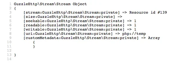

            $data = $response->getBody();
            print_r($data);
            exit();
I get the following output:
190827

            $response = $client->send($request);
            print_r($response);
            exit();
I get the following error:
190830
