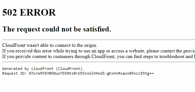

Actually if I go to https://api.developertracker.com/anthem/posts' (with the single quote at the end), I get this:
188691
The server error I posted above shows a 502 error. I double checked in my code to see if I added a single quote by mistake, but there isn't one, which you can see here: const DATA_URL = 'https://api.developertracker.com/anthem/posts';
I'm at a loss as for what's going on.
