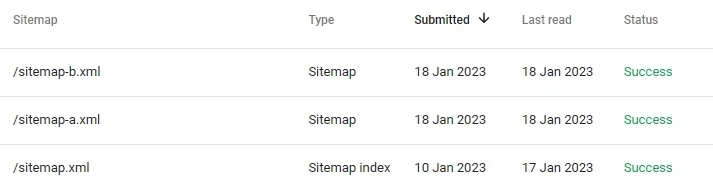

Ok reporting back.
Manually submitting them as single sitemaps didn't work either - Google just gave the same don't fetch error.
However, I was pondering this again today and wondered if it really could be just the fact the number has 2 digits.
So easy test, convert everything over 9 into hex (10 = A, 11 = B, 12 = C etc) and submitted again - low and behold it works!
Now I can submit the last few sitemaps.
I didn't want to muck around with writing an addon for this, so a simple htaccess rule can automate this (and I didn't want to write a map either, coz it's just 5 lines)
# Sitemap rewrite for 10+
RewriteRule ^sitemap-a\.xml$ https://YOURSITEURL/sitemap-10.xml [NC,L,P]
RewriteRule ^sitemap-b\.xml$ https://YOURSITEURL/sitemap-11.xml [NC,L,P]
RewriteRule ^sitemap-c\.xml$ https://YOURSITEURL/sitemap-12.xml [NC,L,P]
RewriteRule ^sitemap-d\.xml$ https://YOURSITEURL/sitemap-13.xml [NC,L,P]
RewriteRule ^sitemap-e\.xml$ https://YOURSITEURL/sitemap-14.xml [NC,L,P]

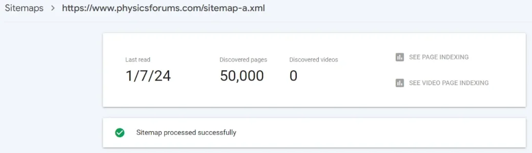

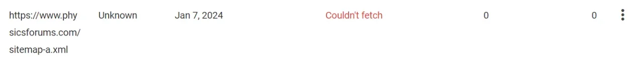

I've been plagued by this issue for a couple of years and tried this method. It's a bit strange. The main screen still says "couldn't fetch" but if I click into the sitemap it returns the URL count successfully and says it's a success. wtf is going on?
