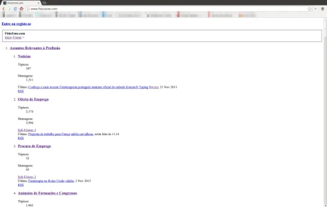

XF 1.2 Google Chrome
From what I can see, your server is returning a 304 not modified response from the CSS when it shouldn't be (even when the browser is sending a header saying it doesn't have a cache). The result doesn't even appear to be served via PHP, based on the headers returned. I can only guess that you have some caching applied somewhere that is causing this.
I just checked with my hosting provider and they confirmed that there's no cache settings in the server, and I certainly didn't apply cache anywhere. Do you have any idea how I can fix this problem? I am lost here.
