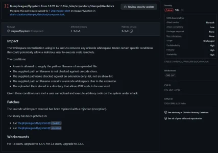

We maintain/deploy our system via GitHub, earlier today we let DependaBot take a look at the code and it immediately triggered a warning on the dependency of league/flysystem-memory:
We can't merge the fix (XenForo would complain about invalid files), but maybe this is something that you could check? Thanks in advance!

league/flysystem-memory is only a dev requirement and is not used in production.

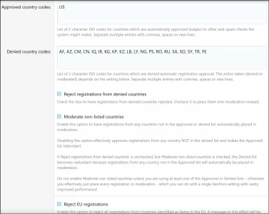

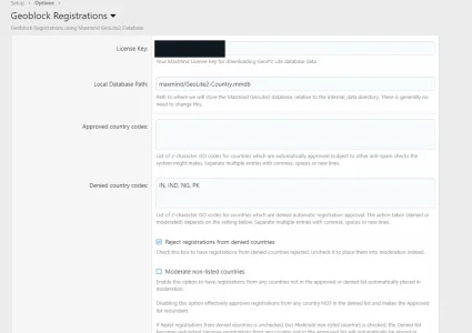

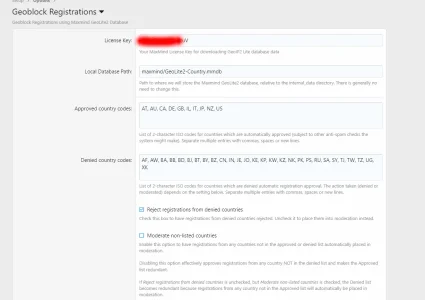

Here ya go:
I can't see anything wrong with your configuration.
Are people actually registering from those countries? Or are they using proxy servers to hide their actual location?
What does the spam trigger log say? It won't show allowed users - but is should show users that were blocked.
I also note that you don't have the "Moderate non-listed countries" option checked - which is fine, but note that this means that the "approved country codes" list is largely redundant since anyone registering from a country not on the denied list will be automatically approved. I recommend turning on "Moderate non-listed countries".

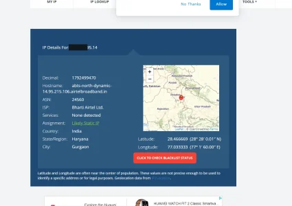

Seem to be having difficulty trying to prevent signups from India.
Have I don't anything wrong?
That's just one example, there's been 30+ signups from India.
Any assistance sure would be appreciated.

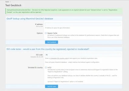

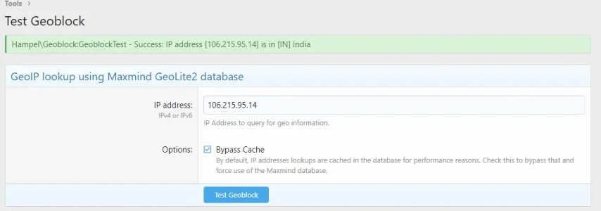

Put the IP address into the "IP Address" test on the Test Geoblock page to see where MaxMind thinks the IP address is located - it could be that IP2Location disagrees with MaxMind?
Don't forget that this addon won't prevent users from doing anything once they are already registered - it only operates at the point of registration, so if they already had an account before you set up the addon, they won't be prevented from posting.

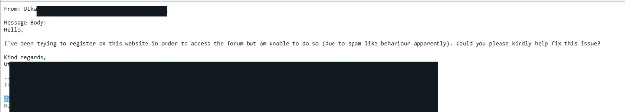

Sorry, I thought I included that screenshot;
Understood regarding point of registration, thanks. It was new registrations this morning. I'll double check everything this side to see what happened.
Many thanks for the response.
[Edit] Sorry, can I just double check. Does this add on block registration totally, or put user state to reject?

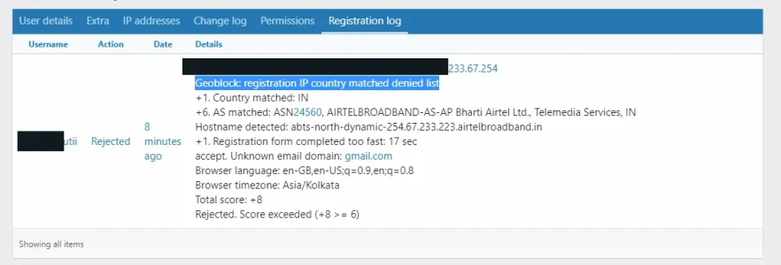

So this person is from India, and it's worked as he's just emailed in;

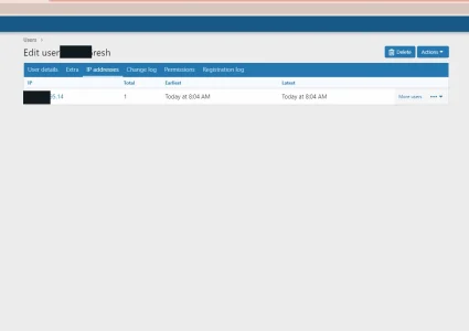

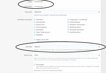

I can see on his account it's been rejected, but the account is still there;
Is this working as it should or should the account not be created at all?
Hope that makes sense, sorry!
The XenForo v2.x spam checker system puts users into the "Rejected" state rather than blocking them completely - so that is normal operation.

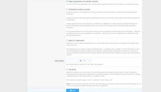

Pardon the dumb question. But, I'm a bit confused with the moderate non-listed countries section.
Initially, I wanted to automatically reject the countries I added the the Denied Country Codes box and the EU. And, I've still been getting moderation requests for countries in the EU, like Germany. But, now I have decided I want to automatically reject all countries outside of the U.S. What is the best way to set that up in GeoBlock? Thanks!
I'd have to look into the EU thing - the addon relies on MaxMind flagging an IP address as being inside the EU, so if they aren't flagging them correctly, then it won't work effectively.
It would be useful to know which IP addresses are getting through with the EU rejection setting enabled so I can troubleshoot that - could you send me a PM with some details if you have them?
Unfortunately there is no way to automatically reject countries - they have to be explicitly listed in the denied list.
If you really want to block registrations from every country outside the US (noting that all it takes is for someone to use a proxy or VPN to bypass this!), then simply add county codes to the denied list every time someone registers from outside the US - it will take a bit of effort up front, but over time you'll see fewer and fewer new registrations from other countries.
