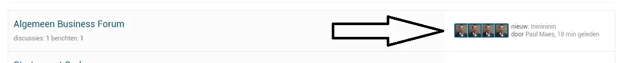

1st i got the last post avatar installed long time ago.....then genesis came.....installed it over last post avatar as told.......worked ok besides the menu that was out of alignment......then your update of genesis came......updated it.....then......issues/problems/conflicts came along with as a result.........4 avatars in 1 post......cannot install genesis again......need help! :-(

I'm a little confused with your timeline.
The issue with 4 avatars is probably to do with your style. Perhaps it already includes some last post avatar code.
Try installing Genesis manually by uploading all the files and then installing the XML file. Once installed, go into the style properties for your theme, go to Forum / Node List and disable the last post avatar option and see how many avatars appear once it is disabled there.
If you still have problems, please PM me.

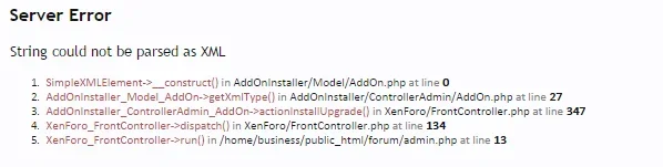

thanks for the rply......unfortunately i cannot install the genesis again......errors
this is the error when trying to upload the xml file
The existing data required by the data- writer could not be found.
That error is to do with files not being uploaded correctly I think. @Robru had the same issue.
Sounds like a bug with @Chris D's add-on installer. Try disabling that add-on and try installing again.
yes...that solved it....but why suddenly his addon gives this error....don't know but problem s solved....therefore...thanks a lot for your help
