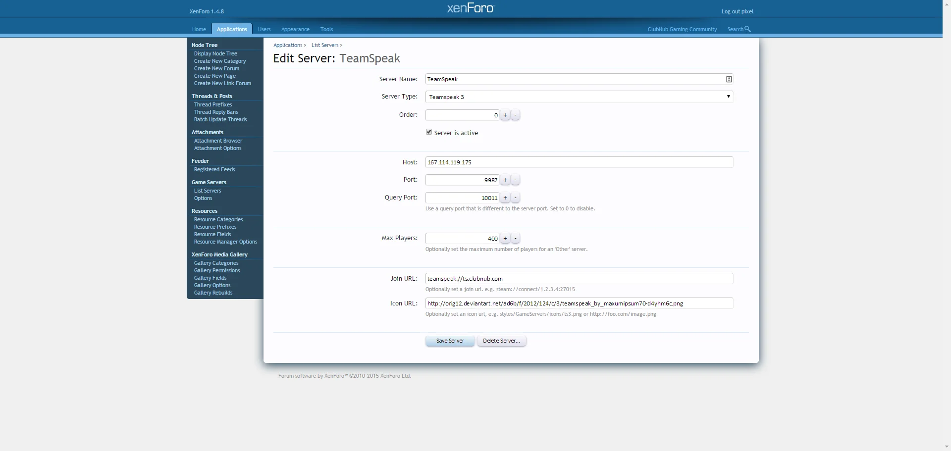

ClubNub
Can you send me a screenshot of the server edit page for your TS3 server, and if you open up library/GameServers/GameQ/gameq/protocols/teamspeak3.php, can you copy what the following line says:
protected $master_server_port =
And by "doesn't work" you mean the player and max players count stays at 0?
Sorry for not being descriptive with the error (I personally hate that). Yes, the counts are staying at 0.
protected $master_server_port = 10011;

I just tested your server with the same settings and it is showing as 11/400 for me.
Are there any errors in the XenForo server log, or the PHP error log?
Can you also PM/message me the PayPal name and email you used to purchase the addon?
