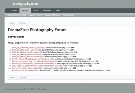

Forum was working fine and has just started to break ....
Loads of errors on the error log like
Mysqli prepare error: Unknown column 'thread.username' in 'field list'
library/Zend/Db/Statement/Mysqli.php:77
All in the same library
I can still access the admin

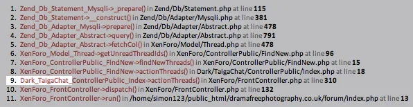

From the forum if you try and do anything you get the following

Everything I've read on this seems to indicate the problem is with using incorrect single quotes in a query, assuming of course thread.username and thread.thread_id still exist (they're both fields in the thread table).
Did you do anything/make any changes prior to this error appearing?

As Jake has pointed out, it could be related to the chat add-on.
So try disabling that first.
