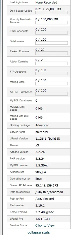

Let's make sure Host Gator didn't just flip a switch. Because YOU maybe using php 5.3, but if they still have other people using php 5.2 on the same server, it doesn't matter what you're using.
In htaccess look for the following
AddType application/x-httpd-php53 .php
OR
AddHandler application/x-httpd-php53 .php
If you find either (or both), they did a switch on you. And you can verify this by changing php53 to php52
If you don't find this.
You can try adding one of these (see which one works)
AddType application/x-httpd-php52 .php
OR
AddHandler application/x-httpd-php52 .php
Then upload the attached and navigate your browser to it. It will tell you what version is now running for you.
