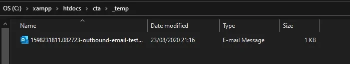

If XF is functioning correctly, there should be a text file generated in the internal_data directory.
I do not get a text file within internal_data, with the code added to src/config.php, when sending test email from /admin.php?activity-summary/send-test-email

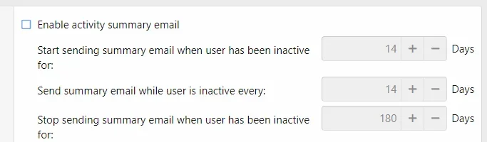

Coming back to this - did you actually have the option enabled when you were sending the test email?
Even though there is a confirmation message that the email is sent, if the feature is unchecked, nothing is sent.
That is the only way I can reproduce the issue.
I have raised it with the developers - either the email should be sent, or the option to send the test email shouldn't be available (especially as the confirmation message is misleading).
