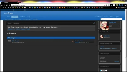

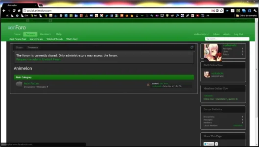

Is this broken Eric? ,the "style-Flexile-Dark" gives me a crazy arse theme
style-Flexile-Dark
style-Flexile-Dark-Green
Pretty odd huh.

Have you installed the base Flexile Dark style before installing the colored versions as child styles? If you don't already have the original (light) Flexile installed, you'll want to use the style-Flexile-Dark-Standalone.xml file. :)

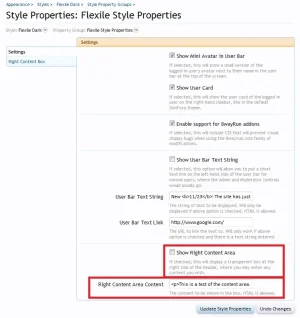

I can not figure out how to change the "content area" to save my life. I would enjoy any help that can be given.

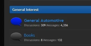

The read/unread icons seem backwards to me. The read one is brighter than the read one. How do I reverse them? Will they be changed back when I upgrade the template?

No, that doesn't work. If you actually look at those files they are just the outlines. I believe it's the background colors that need to be switched? How can I do that to test it?

Ah yes, I see.
Could try this and hope it helps.
In EXTRA.CSS add...
/* Change forum node bg colours */
.node .forumNodeInfo.unread .nodeIcon, .node .categoryForumNodeInfo.unread .nodeIcon {
    background: url("styles/flexiledark/xenforo/node-sprite.png") no-repeat scroll -44px 0 #0022FF !important;
.node .forumNodeInfo .nodeIcon, .node .categoryForumNodeInfo .nodeIcon {
    background: url("styles/flexiledark/xenforo/node-sprite.png") no-repeat scroll 0 0 #111111 !important;
Blue becomes unread (or new posts) and grey becomes read (or old posts) in this example.
So, close. That does in fact work (except the correct theme blue is #217BD5, not #0022FF) for the blue scheme. However, I allow my members to choose from all of the different color schemes. This seems to also make the Orange, Green, etc. themes use the same colors. I believe this is because they are child themes. I tried putting different code in the EXTRA.CSS of each child theme, but it still resorted to the blue ones.
Can you advise how I handle that scenario? Don't feel obligated, you've helped a lot already. :)
Thanks.
Find this CSS in the node_list.css file and swap the background-image and background-color attributes. This works because it edits it where it is defined instead of overriding it in EXTRA.css. :)

This should be inherited down to the other colored child styles. :) Just be aware that unless you make this change in a child style to the "base" Flexile, you will need to make this edit each time you upgrade the style. :)
