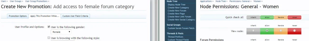

1. Gender based access permission. Women forum for women only, vice versa for men. I was instructed this can be done with usergroup promotions. To quote
Gender-limited forums can be implemented via user group promotions: https://xenforo.com/help/user-group-promotions/ Users would be added to a group that has access to specific additional forums.

  1. It's only complicated if you choose to make it complicated. It's actually very simple, but I appreciate anything that isn't familiar may on the surface appear complicated. As you pointed out, that add-on hasn't been updated for 2.5 years. If it does still work, how long will it work for? Ultimately that situation would probably be more complicated. If there's anything you're unsure of or don't understand, just ask.
As mentioned by Chris D, this can be done very easily through XenForo's officially supported systems. Here's a screenshot of something you'd see (I removed some options from the screenshot to make it all fit in one page. Don't forget to revoke the "View Node" permission for the default user group, for your gender specific forums. Just do this and you're good to go! :)
