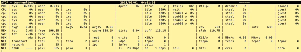

When I run top on my 2GB VPS this is what I get
and atop gives me this
As you can see, it's reporting the memory assigned to my VPS. Your image is showing 40 times that amount.... where in the heck are you getting a 80+GB VPS from?
That's about 8TB of RAM showing up in his figures, not 80GB. There is obviously something wrong somewhere.
