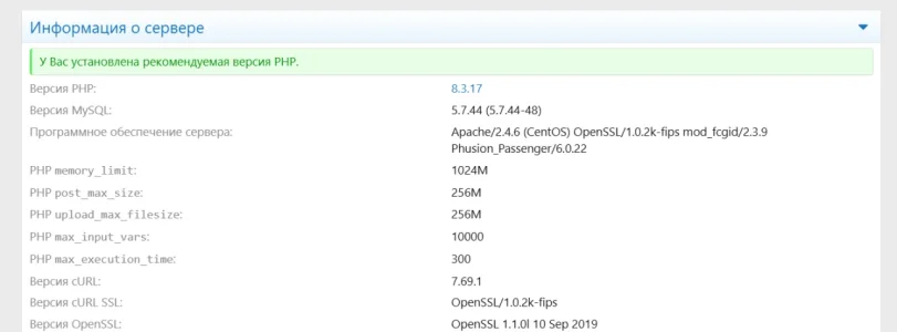

Hello everyone. Maybe someone can tell me where to dig.
Recently, errors like
Fatal Error: Out of memory (allocated 112578560 bytes) (tried to allocate 20480 bytes)
The error appears on the main forum page at random times.
At the same time, all limits have long been increased:
When communicating with the hosting provider, I received the following answer:
At the specified time, PHP processes occupied more than 900 MB of RAM:
Upload all images and files only to our server!
For the Host tariff plan, it is impossible to use more than 1 GB of RAM per process.
I want to add that it is generally strange that at the moment of observing the problem (for example now):
Fatal error: Out of memory (allocated 113246208 bytes) (tried to allocate 20480 bytes) in /var/www/u0513784/data/www/politsim.ru/src/addons/ThemeHouse/Nodes/Repository/NodeStyling.php on line 178
