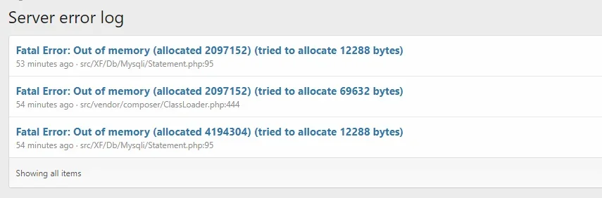

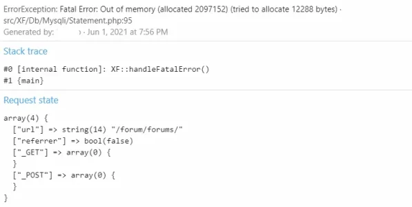

I'm having the same problem, did you solve it?
My server has 1GB of memory and the limit is 128mb
That's not the same error and thus a different cause. "Out of memory" means that PHP couldn't allocate memory because the server/OS wouldn't give it any. In your examples, PHP couldn't get more than 2-4MB of memory before failing.
Your server very likely needs more memory or you need to make adjustments to change how memory is being allocated to the various services running on it.
I thought it was the same problem, sorry.
I will increase server memory

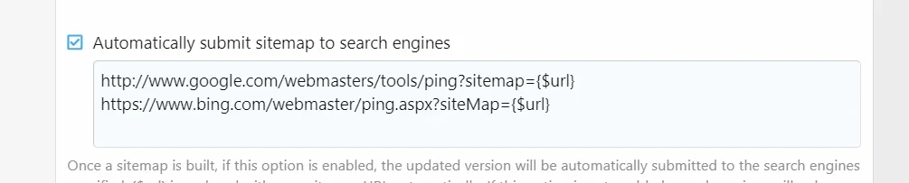

I'm also getting regular errors about submitting sitemaps to Bing on multiple sites. Can't find any solutions so the errors are just stacking up at this point.
For Bing you can change the sitemap URL in xml sitemap options to this.
https://www.bing.com/webmaster/ping.aspx?siteMap={$url}
This make them go away. For other error you just need to configure your server properly.
