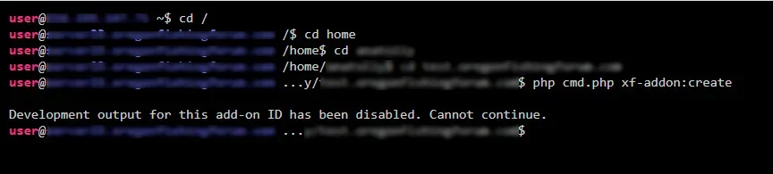

I'm a noob, just installed a test xenForo, follow xf2-docs/dev/ and when I got to "Create the add-on", I'm stuck. I run '$ php cmd.php xf-addon:create' and getting 'Development output for this add-on ID has been disabled. Cannot continue.'
What could be the reason? Thanks in advance.

I thought that maybe it's a conflict of 2 forums on the same domain, so I installed xenForo on a different domain. Now in ACP I see "The following issues should be resolved. Once they have been resolved, check for upgrades again to confirm. The Board URL option does not match the site URL configured for your license." When I run '$ php cmd.php xf-addon:create' I'm again getting 'Development output for this add-on ID has been disabled. Cannot continue.'

well I would ignore it, if xf-addon:create would make it's magic. but it didn't. I got the same "Development output for this add-on ID has been disabled "... so I'm deleting the instalation on the other domain, and going back to new orlean that folder 'test' on my main domain...
what that 'Development output for this add-on ID has been disabled' might mean? for what add-on ID? i tried all possible variants. I guess it means 'for any add-on ID has been disabled'.

I created a folder AV in /src/addons/ , a folder Test in /src/addons/AV/ , and a folder _output in /src/addons/AV/Test . I gave chmod 777 to /src/addons/AV/Test/_output . In terminal I went to the root directory of my forum ( where cmd.php is located) and run php cmd.php xf-addon:create and I'm getting ' Development output for this add-on ID has been disabled. Cannot continue. '
What am I doing wrong? Please help.
Do you get Development output for this add-on ID has been disabled. Cannot continue error right after you run xf-addon:create (which should not throw that error because no Add-on Id is given yet) or after you enter the add-on id?
I did a lot of testing to try to reproduce your error this afternoon and the only way I could reproduce it was to enter xf in the add-on id. It threw this: Development output for this add-on ID has been disabled. Cannot continue, followed by: Note: use of add-on IDs starting with 'xf' is strongly discouraged.
The error above is thrown because of this check: if ($devOutput->isAddOnSkipped($addOnId){...}, do you use 'xf' in your add-on id? As that is the only way I can reproduce it. Note that I did try out creating this manually AV/Test/_output (as per your example) as part of my testing, then ran the create command and it worked as expected.
