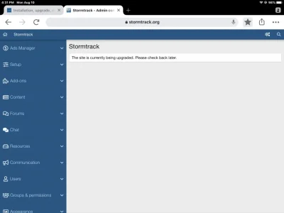

What table do I drop from the database after an upgrade failed to complete? Upgrade to the latest version hung and I need to clear whatever database entry is keeping the forum stuck in the upgrade mode. Is it XF_Update_Job or something similar?
Yes, I went through the normal process and it never completed. It’s showing the latest version in the lower right corner. Anywhere I try to navigate it displays the above message.
No errors but I cannot navigate anywhere to know whether there are errors or not. I’ll do the config file thing after I quickly eat. I just read the upgrades FAQ and nothing there is jumping out at me.
Thanks for holding my hand Brogan! I finally figured it out and solved the issue by renaming the table to xf_upgrade_job to add _old to the end. Then a new table was created and problem solved. I did this once before but I couldn't find the post I used as a reference for the life of me. I appreciate your help.
