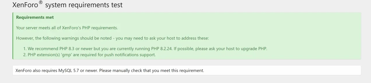

I checked mydomain.com/install/ and all it shows is that xenforo 2.3.3 is available download but I already have that version of Xenforo.
I contacted my hosting provider to see if it was a PHP issue but they told me that wasn't the issue.

Checked my server error logs and this is the latest:
[28-Nov-2024 14:47:48 UTC] PHP Fatal error: Uncaught Error: Call to undefined function mb_internal_encoding() in /home/c8...../public_html/src/XF.php:138
Stack trace:
#0 /home/c8................../public_html/src/XF.php(112): XF::standardizeEnvironment()
#1 /home/c8......./public_html/index.php(15): XF::start()
#2 {main}
thrown in /home/c8....../public_html/src/XF.php on line 138
Had my hosting provider check other PHP settings on the server and they said nothing was wrong.
