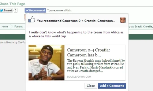

@Mike I don't want to create another thread about this issue. It looks like i am having the same issue here - This has been working well for me and suddenly stopped working yesterday. I have been trying to recommend a thread to Facebook and it is not appearing on Facebook when i clicked add a comment. I have also logged into my with Facebook integration and had my Facebook account logged in also. I have the XF 1.3.3
What could be the cause of this?
