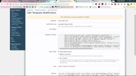

UPDATE2: Figured that the add-on used Template Modifications. So, I went to modify it so that it'd add new og:image meta tag right before og:type meta tag instead. This way I can have 3 images with the logo set to have its own structural properties. Example (view the source): https://www.endlesshorizon.net/threads/alright-gather-here-those-who-are-waiting-for-deadpool.416/
As reference, here's my setting for the template modification:
Find:
HTML:
<meta property="og:type"
Replace:
HTML:
<xen:set var="$og_image_custom"><xen:callback class="OpenGraphImage_Callback" method="getImage" params=""></xen:callback></xen:set>
<xen:if is="{$og_image_custom}"><meta property="og:image" content="{$og_image_custom}" /></xen:if> <!-- adds an additional og:image meta tag if the callback returns link -->
$0

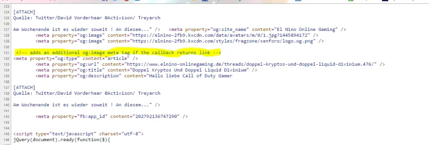

i have the problem that it always showing my avatar .
i have full view of images
i have tried this :

bit its always showing my avatar pic :(
Yeah, the default meta tag wasn't being replaced for some reason.
If you haven't applied my customization, then there had to be something wrong with the add-on. Though I doubt that my customization will help..
I just checked your site again. I see that you've applied my customization (the HTML comment was intact). But unfortunately, the callback didn't return any image.
