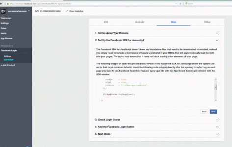

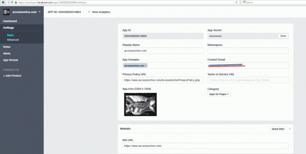

Hello,

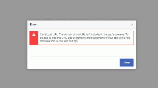

I have spent a few hours messing about with the Facebook APP interface. I think i have read every single post about this. I have my APP live and everything per your instructions. So what am I doing wrong?
See attached
It doesn't help that Facebook changes this interface so often (and hence our documentation is out of date) but I think you now have to click "+ Add Product" and add "Facebook Login".
You will then get some various OAuth settings and filling in these should get the app all set up for Facebook login.

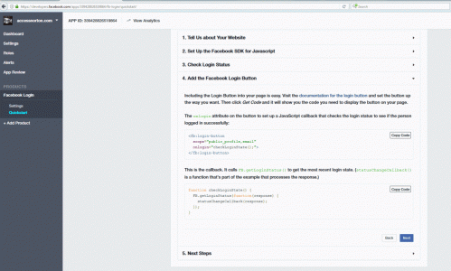

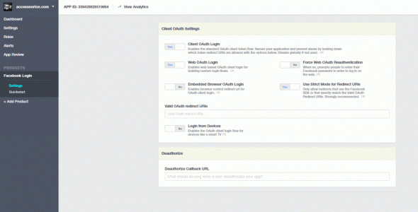

I am sorry they are constantly changing it. What a pain. I was able to get this far and it still does not work. See image-- what to do next? Appreciate your help.FB-login4.gif
I'm fairly sure the "Valid OAuth redirect URIs" section is something fairly new -- that's likely the thing it's expecting to see.
As for the value it expects... it can vary from provider to provider. Try just simply putting in your domain name accessnorton.com.

In "valid OAuth redirect URIs", enter "https://www.accessnorton.com/" (or for anyone else, your domain). Now disable "use strict mode for redirect URIs" and be sure the save the changes at the bottom. I believe that should allow it to work.

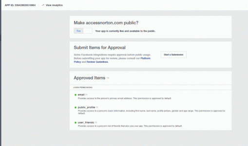

So is everyone having trouble with this? Someone needs to make a guide because I'm getting "can't load URL" error on both my installs and it's frustrating. What settings are people using to get this to work?
I'm looking for a solution also. One of my XF1.5 sites works and the other quit working with same settings on both. Both of my FB apps were live and working bur now one of them is no longer live and I get this message when I try to make it live.
You must provide a valid Privacy Policy URL in order take your app Live.
