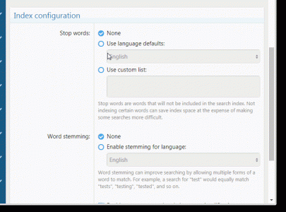

I have ES up & running but I'm unable to make any changes to the "Index Configuration" options in the ACP (for Word Stemming and Stop Words). When trying to make any changes to them it appears as though they are saving and the screen refreshes but after the refresh the options are back to their defaults again. All other ES options are able to be changed. Nothing shows up in the browser console during the save and no errors reported from Chrome's 'network' developer tools menu.
Thoughts? Just me? Something with my Elasticsearch installation? XF ES bug? Not enough coffee?

Just checked... yep, after choosing either "Stop Words" or "Word Stemming" it does the page postback and the green 'Your changes have been saved. To finish this action, you must now rebuild the search index.' confirmation message is at the top of the page. Other options on the page, like 'Enable accent removal and character simplification' work as expected (meaning that their state is saved after changing the option), just Stop Words and Word Stemming are giving me grief.
