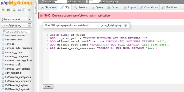

Tried that too, same error....Remove the 3rd line of that query.

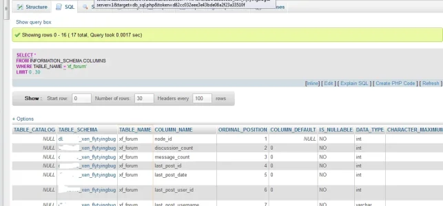

Is that what you mean?That screenshot doesn't show the complete table structure.
Thats everything that is displayed after doing what you requested. http://xenforo.com/community/threads/error-when-trying-to-require-prefix.62569/#post-663993That's still not the entire table but from what I can see, those four columns related to that add-on now look OK.

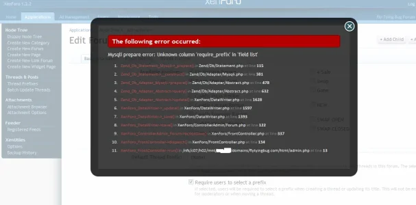

What happens now when you try to require a prefix.
I think that did it, no more error when I require prefix, Thanks for your help Mike and everyone else that chipped in, cheers.Run this:
Presumably when you uninstalled the add-on, it re-removed the column (hence the importance of prefixing tables/columns).Code:ALTER TABLE xf_forum ADD require_prefix TINYINT UNSIGNED NOT NULL DEFAULT '0';
