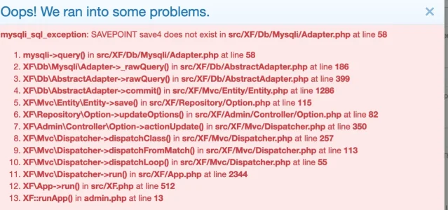

Anyone any thoughts on this error when trying to change Board URL (to remove www.) in ACP?
We're running a slightly older version of XF so I'm wondering if it's a PHP issue?
It did seem to change the board URL but is it safe to ignore the error?
Generally exceptions negate any operation from applying by rolling back the transaction, so I'm surprised it saved at all. I don't think there would be further adverse effects in this particular case, but I wouldn't recommend running PHP 8.1 before at least XF 2.2.8 and preferably 2.2.13 as other issues may not be as clear-cut.
