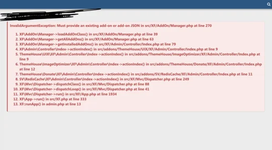

I have a problem: When I access to Admin CP, it give me this error:
193100

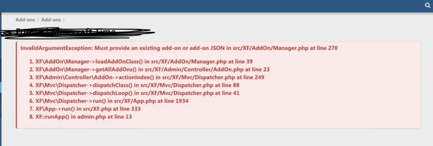

And when I access to list add-ons list:
193102

I think this indicates an add-on that is missing the necessary JSON file. Look at the add-ons on the file system within the src/addons directory. If there's one (probably with a _data sub-directory) without an addon.json file in it, that is likely the culprit. You should reupload the files for that add-on (or remove them entirely).
