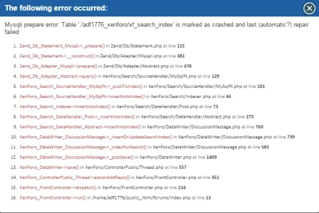

I was getting A server error occurred. Please try again later. when trying to post. To resolve the issue I clicked repair in phpmyadmin and but now I am getting this error when attempting to post:
Apparently the repair failed, does the guy here know what he is talking about with running the repair manually?

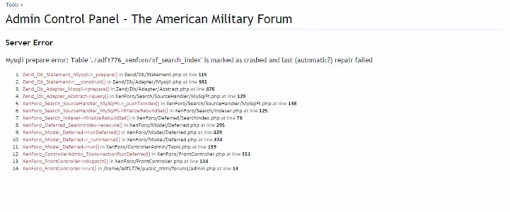

Mysql says that it returned an empty result set, I also got this after rebuilding the searches
When attempting to access the actual search index table in myphpadmin it says that it has crashed
You may need to contact your host if the table is crashing continuously.
A repair or truncate and rebuild is typically all that is required to resolve it.
