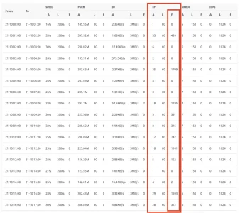

I've a problem with entry process limit on my cloud hosting cPanel managed space. In fact it is limited by the hosting service to 60, but as you can see in the graph it exceed too much.
The question is: Is it normal that XenForo do so much EP at the same time or should be an add-on issue or something else that can be resolved.

Here's how Cloudlinux describes Entry Processes:
EP stands for “Entry Processes”. This is the number of concurrent Apache connections your site can sustain. Don’t confuse this with total number of connections – that could easily be in the hundreds or even thousands. Concurrent means processes happening at the same time. An easy way to visualize this is 20 visitors all clicking a link at the exact same second. You could have hundreds of visitors on your website but the likelihood of more than a handful doing things simultaneously is very low. Sites that hit this limit are generally getting hit hard by bots and crawlers. If your site hits this limit it will display a “503 Service Temporarily Unavailable” message.
So either your site is extremely busy or you are getting a DDoS attack or such.
