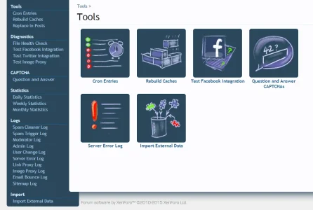

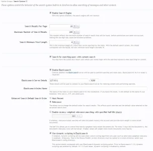

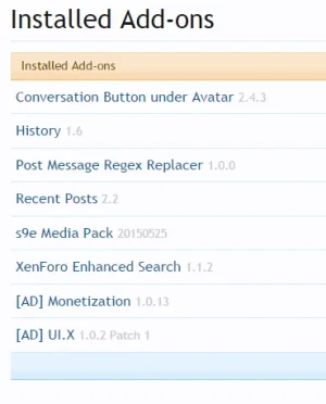

I know we purchased it and installed it and tested it. As well as "elastic." But where do we set the parameters for the Enhanced Search?
Thanks!
Andre

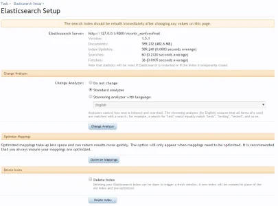

OK, so if I install this right now, on a "live" forum, is there anything I should expect to break? Any maintenance I have to do after?
And is this the same for the resource manager? The settings for this should also be under tools?

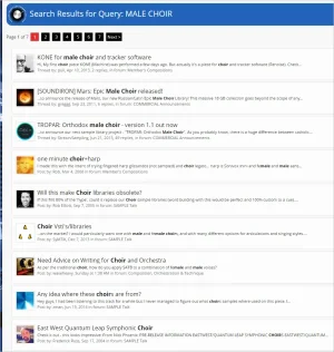

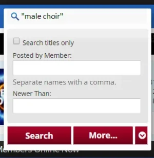

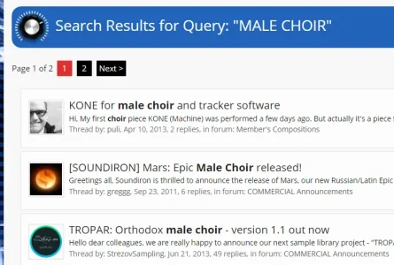

OK, I searched for "male choir" which is a term that should give me many results. Only two results, and they were part of a conversation I was having earlier today.
What am I missing? Thanks for the help!
It works fine for me.
If you are using an add-on which allows conversations to be searched then it is a limitation of that add-on due to how search results are fetched.
