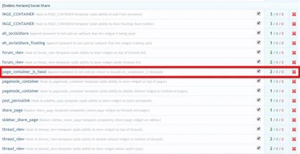

Can you please help me fix this error:
1-png.145272
There are a few possible causes for this issue, as far as I can remember. First is because the add-on cache hasn't been rebuilt correctly. Second is because the JS template isn't being included properly. To confirm the second cause, you can check Template Modifications in Admin CP and see whether the template modification for page_container_js_head is working properly (there's no grey or red number):

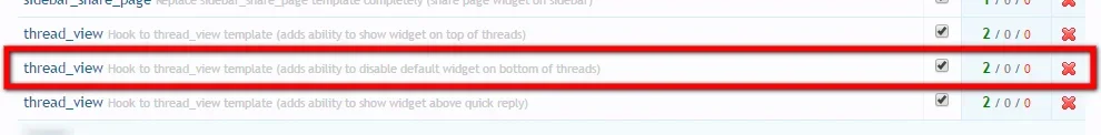

Because my add-on directly modifies share_page template, I suggest directly modifying the add-on's Template Modifications (you'll need to enable debug mode while modifying them).
To display the default XenForo share page links for threads alongside this add-on's, you need to look for this add-on's Template Modification for thread_view, specifically the one which "adds ability to disable default widget on bottom of threads":
Then replace the content in Replace section into:
HTML:
<xen:include template="share_page_default">
    <xen:set var="$url">{xen:link 'canonical:threads', $thread}</xen:set>
</xen:include>
<xen:if is="{$xenOptions.EHSS_ViewThreads.bottom}"><xen:include template="share_page"></xen:include></xen:if>
After that, go to Templates, and make a new template called share_page_default, and copy everything from share_page template into it.
By the way, you can move the section which includes share_page_default template from the new Replace code into before/after the line which adds the original Replace code.
HTML:
</xen:include>
