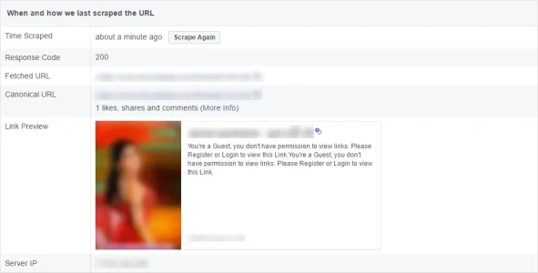

Still are not working. Are not remove [ img] tags from facebook share. Please let me know that what i can do?
You just had to re-scrape the particular thread with this tool since Facebook caches the result (what it fetched for the first time will be used in the future even after you edited the thread - I think there's a documentation on how long they cache the content somewhere, but I can't remember).
Here's the result of the URL you had issue with after I re-scrape it:
edit: sorry for the delay btw, had some issue irl
I thing that caches issue. Is this Ok that I am using this code?
/\[(IMG|ATTACH|img)\]/
