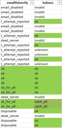

As a test, I submitted the same list of 25 email addresses (ones that I knew were a good mix of valid, invalid, catch-all, etc.) to three companies:

The first two companies processed the lists pretty quickly. The third one is still "processing" a day later. I emailed support 2 days ago to find out what was going on and still no reply.
Results from the other two:
hubuco is definitely way cheaper, but their results are not as robust.
Have any of you used any of these services?
