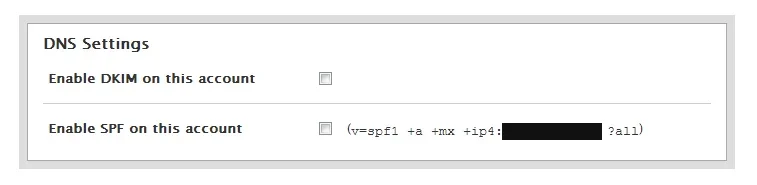

DKIM and SPF set up correctly on the domain to make sure the IP address is listed as a valid sender?
So, I assume we need to enable these?

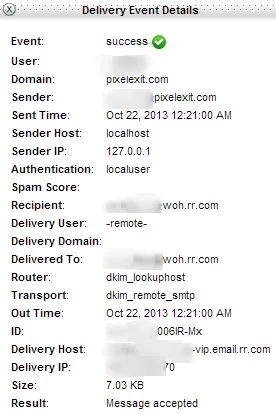

I would check your mail logs (/var/log/maillog usually). That would give you delivery information at the least.
I have one of the maillogs saved to a text file. What should I be looking for? Nothing is really standing out to me.
Thanks
Well, you want to search it for the email that failed to be sent (so using a unique email is useful). It should have a unique identifier listed for the email and you can then search that ID to follow through with all the information about that email. You may want to compare with a successfully sent email to compare. If the email appears to be sent successfully, it could be an issue on the receiving side or it could simply be that it's routing somewhere you don't expect (like delivering it locally instead of via SMTP).
