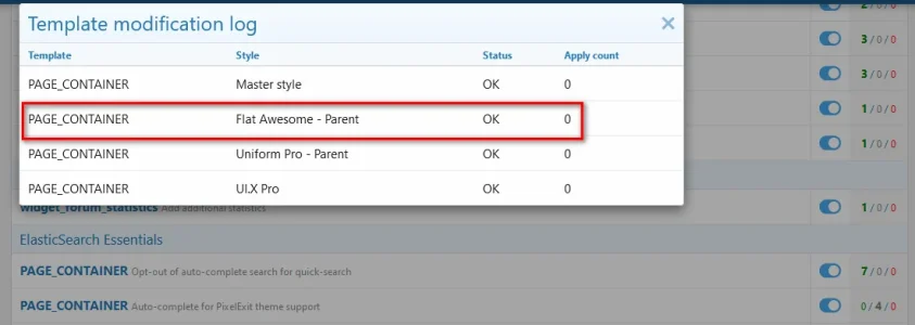

That template modification not applying is fine, you don't need to worry about it. Next version will update the comment to describe it is a compatibility fix, or have it removed

@Xon PixelExit style support added but we have @Russ Flat Awesome style that are not applied Template modification.
It is conditional support, not every template modification will apply. There should be an xbsearch which is applying instead.
