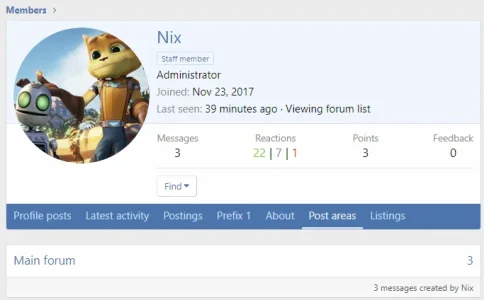

Is there a screenshot showing "On a user's profile, shows forums by post count where the user posts the most." functionality? Don't see it enabled at https://atelieraphelion.com.
How is this feature working on large forums? Is it cached?
Most of the search add-ons aren't installed on my site, as they generally require XFES, which I don't have installed on there. @NixFifty's test site has most of those; including this add-on. Attached is a screenshot;
