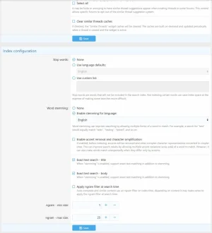

Ensure stemming is configured and also enabled near-exact text matching options. You'll need to rebuild the search index after that.
can you explain this to me in details ? where todo this
some HOWTO please
regards
This is stock XenForo Enhanced Search configuration options.
AdminCp => Setup => Enhanced Search => Index configuration, and make sure "Word stemming" is set to your language (or English)
done. rebuilded index, no effect

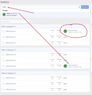

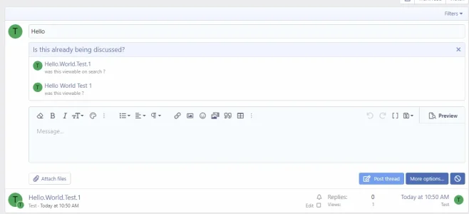

Threadheaders with dots dont found
strange, on Forum search dont found but on similar threads was found
The elasticsearch standard tokenizer (which is based on the standard Unicode Standard Annex #29) which splits text into indexable chunks simply doesn't handle the '.' like you are after.
This can kinda worked around by enabling the "Apply ngram filter at search time" which makes the text splitting vastly more aggressive (only only for autocomplete!), but it doesn't fully solve this problem which most users don't have.
What is happening is "hello.world.test.1" is being treated as a single blob, and "hello.world" doesn't match that.
hmm makes no sence, similar threads found and search dont... confused

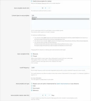

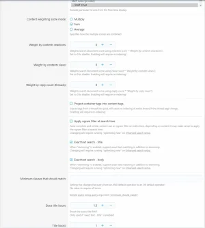

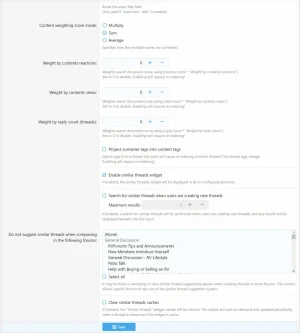

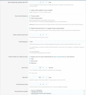

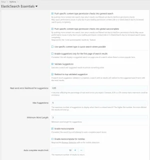

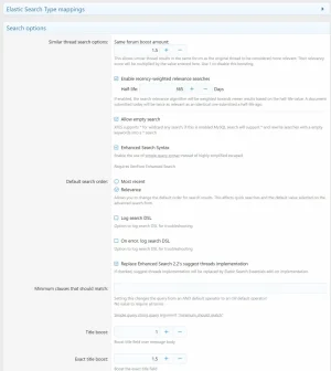

I have the latest add-on installed, rebuilt search indexes, have stemming enabled, etc. etc. and cannot for the life of me figure out why I can't get any results in the search box for the search term "avata" on my site https://rvforums.com which is to find posts on the DJI Avata. If you go to my site and type avata in the search box the auto complete list is not showing it and I don't know why. Any idea??
You have some settings I'ld recommend changing, some of them are just older defaults:
  • Enable "on error log search dsl" otherwise search failures are next to impossible to debug:
  • Title boost: 1.4
  • Exact title boost: 2
  • Weight by reply count (threads): 0.4
This will require a re-index to enable to 'Weight by reply count (threads)' feature, but it definitely helps.
