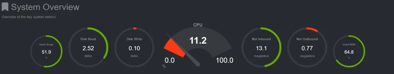

There are 3 components that could be causing the delay;
  • Query time for elastic search (http request to elasticsearch)
  • mysql fetching results (mysql query)
  • php processing results
What value does "Maximum number of search/find new results" have? Try setting it to 400-500 or less

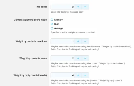

Hi @Xon, great work! (y) Just renewed all my licenses yesterday. Now I'm ready to move to XF 2.2 :)
I'm wondering how the "Weight by X" feature works and what numbers you would recommend:
Would you set them lower or higher? While I'm trying to figure it out and test the search results I have no feeling yet about how high and in which relation the numbers should be set.

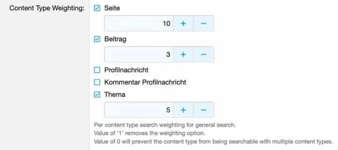

And since your other addon "Search Improvements" also offer weighting (based on content type) I was wondering if these values are considered in the same calculation or if there is an independend weight caluclation going on?
Thanks for your help!

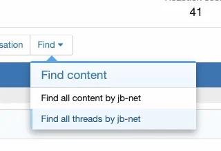

Soft deleted threads no longer visible for staff on find all threads page on user profile:
They are visible without this addon.
They options do work together (for "relevancy" search but are ignored for other sort types), but sadly these do require some tinkering. These features where funded for a client, and part of that was tinkering with weighting for their setup.
Having the soring mode as multiply is a little easier to reason with, as values more easily stack together.
Searching for deleted threads should work via advanced search.
If you have Search Improvements installed, check the "Search Options" on your user profile and check what the "Include deleted" value is.

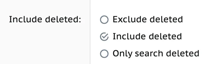

This only shows up for users who can see deleted items, and it is really handy to exclude deleted items if you are a moderator. Otherwise you can just edit the template svESE_search_form_macros_deleted_macro and the macro deleted to remove this option. (don't remove the macro, just make it empty, or wrap a conditional check around it).
@Xon will there be a fix for this issue, it is important for moderators?
This is a bug which will be fixed in the next version so the user's "include deleted" default options are respected.
