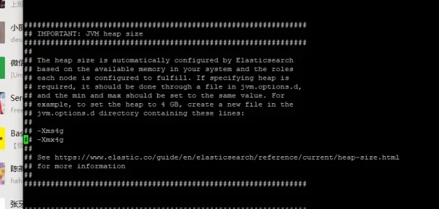

where should I change the memory usage size?
in my file jvm.options this appears
To clarify, you can uncomment and set the desired size right there in the jvm.options file, but best practice is to create a file in the directory mentioned in your screenshot. I think they mean /etc/elasticsearch/jvm.options.d/ - you can probably give the file any name you want, but probably something with .options extension would make the most sense.
You should copy jvm.optons to jvm.options.d (this should of happened by itself, but if it didn't create it yourself). Then from now on make all your Elasticsearch changes in jvm.options.d. The jvm.options.d settings override settings in jvm.options.
The most important thing is the jvm.options.d file will NOT be overwritten when Elasticsearch updates. The jvm.options settings could be overwritten on Elasticsearch version updates, possibly causing breaking changes.
