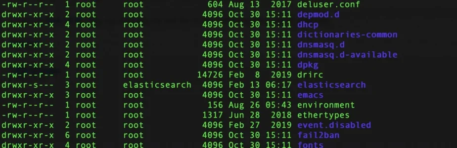

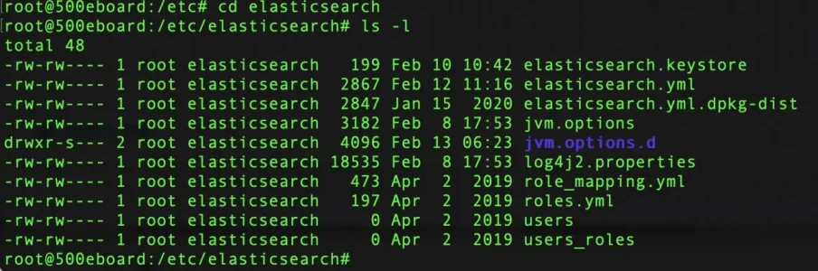

When you do a ls -l of the etc directory in Ubuntu, you will see the following:

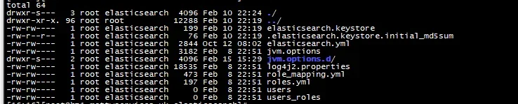

And then when you do a cd elasticsearch, you will see the following:
The jvm.options.d directory is where you want to put the new config file. The jvm.options.d directory was already there (pre-existing) and all I did was copy the jvm.options file into that jvm.options.d directory, and then tweak it as mentioned.
I don't know where elasticsearch puts files and directories in a CentOS system, as I don't run that operating system.
For CentOS, all you need to do is create a new file in the jvm.options.d folder that is appended with the .options extension
You set any additional configuration parameters in there, such as the Xms / Xmx values.

Following up on this situation, I am still having to restart Elasticsearch via my Terminal about two times per day. I am still getting the same curl error 7, failure to connect to the server.
Something happened with the Elasticsearch 7.11 update that exacerbated this condition, causing this error condition to happen multiple times per day from about once every week or two previously.
I have not delved into the error logs to see what is happening and being recorded that is causing this problem.
Upgraded 2 days ago and everything is running OK.
Just add same "option file" to jvm.options.d folder.
Restart ES and voila
