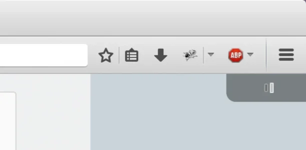

Our members (and me too) experience this behavior once in a while.
It's impossible to reproduce reliably, as it happens totally randomly.
Basically when you click Post Reply, this damn loading icon keeps on loading indefinitely (even though the post has gone through successfully), and then a member naturally thinks that the post hasn't gone through while it has, and clicks Post Reply again, causing a double post, sometimes a triple post.
