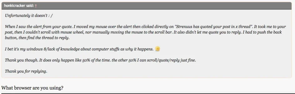

In terms of the screenshot in your latest post, I don't believe there's anything that would block scrolling and that certainly isn't a report we've had before. With certain client actions not working, it does almost seem to imply that the JS hasn't loaded correctly (though it should generally fall back gracefully in that case). Alternatively, it could be down to a server response timing out, though the quote button shouldn't really be involved in locks as it's only selecting so the issues discussed shouldn't contribute to that.

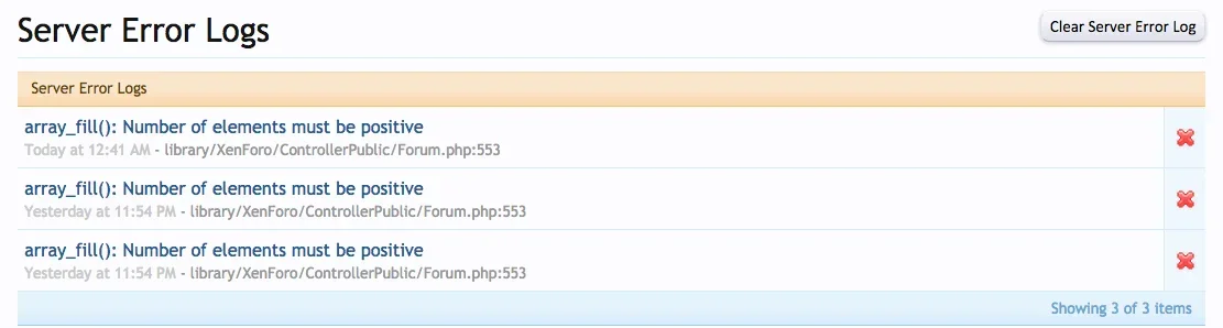

More server errors after the move.
Server Error Log
Error Info
ErrorException: array_fill(): Number of elements must be positive - library/XenForo/ControllerPublic/Forum.php:553
Generated By: Draco, Today at 12:41 AM
Stack Trace
#0 [internal function]: XenForo_Application::handlePhpError(2, 'array_fill(): N...', '/home/mschwartz...', 553, Array)
#1 /home/mschwartz/github/mschwartz/sportstwo-xenforo/htdocs/library/XenForo/ControllerPublic/Forum.php(553): array_fill(0, 0, true)
#2 /home/mschwartz/github/mschwartz/sportstwo-xenforo/htdocs/library/Andy/SimilarThreads/ControllerPublic/Forum.php(13): XenForo_ControllerPublic_Forum->actionCreateThread()
#3 /home/mschwartz/github/mschwartz/sportstwo-xenforo/htdocs/library/XenForo/FrontController.php(347): Andy_SimilarThreads_ControllerPublic_Forum->actionCreateThread()
#4 /home/mschwartz/github/mschwartz/sportstwo-xenforo/htdocs/library/XenForo/FrontController.php(134): XenForo_FrontController->dispatch(Object(XenForo_RouteMatch))
#5 /home/mschwartz/github/mschwartz/sportstwo-xenforo/htdocs/index.php(13): XenForo_FrontController->run()
#6 {main}
Request State
array(3) {
["url"] => string(72) "http://www.sportstwo.com/forums/portland-trail-blazers.123/create-thread"
["_GET"] => array(0) {
["_POST"] => array(0) {
Server Error Log
Error Info
Generated By: Draco, Yesterday at 11:54 PM
Stack Trace
#6 {main}
Request State
array(3) {
Server Error Log
Error Info
Stack Trace
#6 {main}
Request State
array(3) {

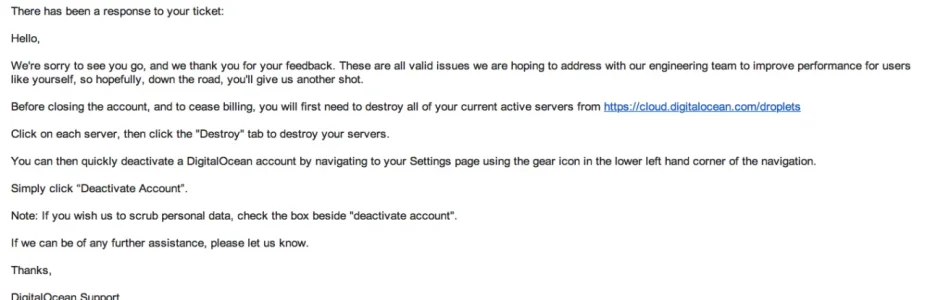

I think everyone might want to avoid Digital Ocean for hosting until they get their act together.
This is the response I got from them after letting them know I was leaving and that their spotty LAN network was causing us issues.
