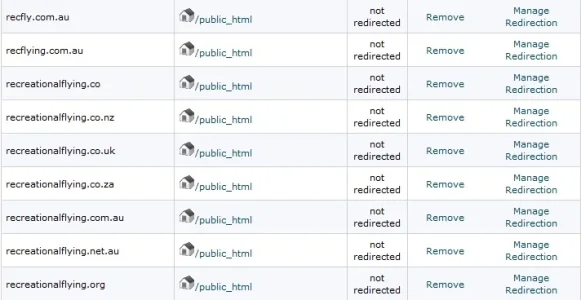

So please correct me if I am wrong but I go into cPanel and just simply park these domains:
recfly.com.au
recflying.com.au
recreationalflying.co
recreationalflying.co.nz
recreationalflying.co.uk
recreationalflying.co.za
recreationalflying.com.au
recreationalflying.net
recreationalflying.net.au
recreationalflying.org
recreationalflying.us
but don't set a redirect for each one so it looks like this:
and then edit the .com .htaccess file and include this:
RewriteCond %{HTTP_HOST} !^www\.recreationalflying\.com
RewriteRule (.*) http://www.recreationalflying.com/$1 [R=301,L]
and now anyone going to say .com.au will be on the .com site and .com will be in their browser web address bar???
