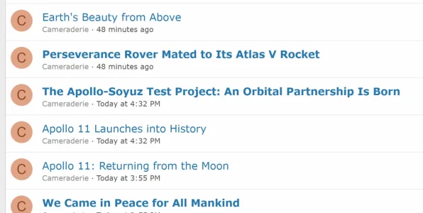

Below is a shot showing a list of recent threads all in the same node. Note the various threads that have word "Apollo" in their title. When viewing the "Apollo 11: Returning from the Moon" thread and the 'Apollo 11 Launches into History' thread, for example, the various 'Apollo' titled threads don't show.

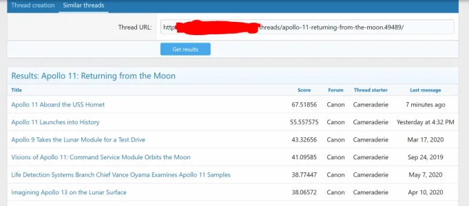

Similar thread result tuning is generally something that we knew we'd need to do post-beta release, as it benefits from tests on various "real" data sets. There is a tool that gives you a bit more info, though I think I may need to expand it to allow some easier query modification testing. If you enable debug mode (it's not accessible outside of that), you can go to admin.php?enhanced-search/mlt-analyzer. From there, you can test the system as it works both for thread creation-based searches and finding threads that are similar to an existing thread.

Here's the results showing for the thread in the ACP tool....

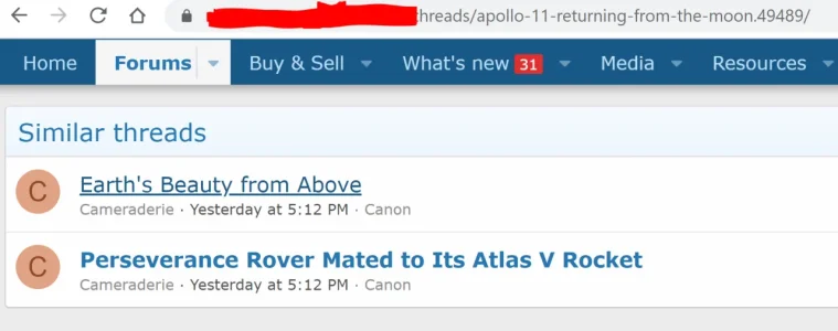

Here's what the widget shows when viewing the thread....

I'm not totally sure why the results would appear to be that different. There was a bug fixed just before the B1 release that could've caused that. The only other way that could happen is if you have added date/forum constraints to the widget (as they don't really interact too well right now).
There's an option on the enhanced search config page to clear the similar thread cache.
Mike, FYI follow-up...
Clearing the cache and then going back into viewing the thread again seems to have worked. đź‘Ť When installing, I didn't change of the widget options for the date range or anything else, it was literally do the XF 2.2.0 B1 beta upgrade from the ACP, poke around the forums, upgrade the addons, poke around the forums, add the widget to thread view using the default options, poke around the forums.
I'll keep an eye open, if I see the widget not matching the ACP tool checker I'll reach out in case any of you guys want to take a look.
