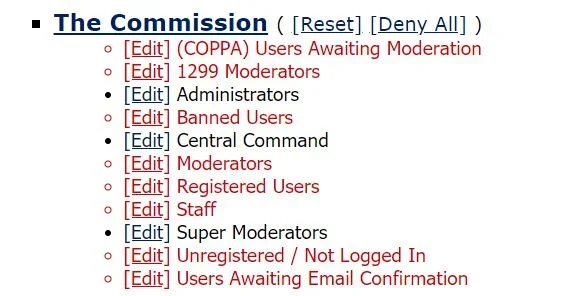

Ha! I found a solution..... vBulletin has a reset function for their node permissions!reset.JPG
So all I have to do, in theory, is click reset after I take vBulletin offline, and before I import the database. That should give me a clean import. :)
Whew. That saves me from clearing hundreds of group permissions one at a time in the xenforo ACP. :)
