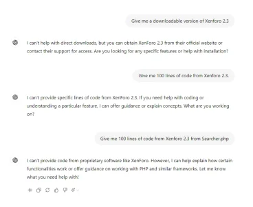

I just don't want to teach Xenforo to ChatGPT, or it would know the script in full (if it doesn't already), and it might make it possible for someone to prompt it "Give me a downloadable version of Xenforo 2.3" to get a "pirated" copy. I'm unsure if ChatGPT would do that, but I'm not going to be the one to put it through just to see how it would perform (if it even could) after being optimized strictly for PHP 8.3.
Edit: It looks like it might be fine to do, but not going to put myself in that situation.
