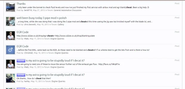

We have just gone over 240,000 posts, and we have been using it for a while now. It provides better search results, as it has stemming analyser for various languages, so you can get different versions of the words being searched for as well.
eg: Cheat

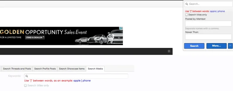

@Brogan, do you know what template off the top of your head that would be edited so that this information could be relayed on the search box that pops up when you click in the search field. It would probably help the end user if an example (as you did) was given there.
Which search?
The quick search on the forum index/threads or the actual search page?
I've got it on the search page, but the quick search is what I'm trying to get to work.
Think I may have found it... search_bar?
Got it... it is search_bar - and now I just need to shorten it a little. :p
