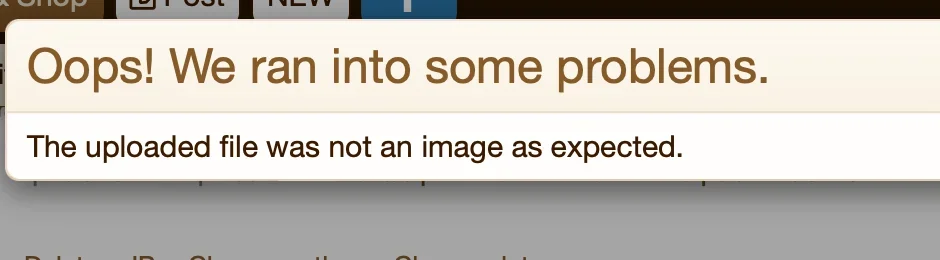

My unscientific way to test is upload the optimised thumbnail to my live 2.2.15 forum. The image (with .jpg extension) does appear to be webp because it shows very briefly then I get this error:
