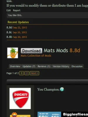

Which version of the RM is this compatible with?
Only ask as I tried it on our dev board, below the resource it showed updates and then the full set of tabs again with the discussion tab added.
Using XF 1.2.2 with RM 1.0.0

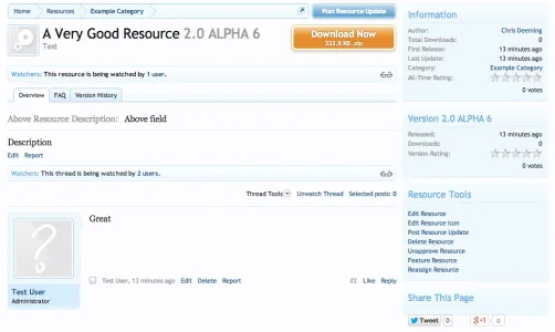

Here is my screenshot from my dev board with Waindigo's add-on enabled and both my add-ons:
It's actually working fine (apart from the Share This Page block but that might be one for @Waindigo to look into as it's caused by the thread_view share_page.css I believe).

Thanks for testing this out Chris. I hadn't even noticed the Share Page appearing twice (and messing up in the sidebar). This is now fixed.
Unfortunately, this add-on, due to its nature (i.e., merging two different pages into one), is more likely than most to cause CSS issues with some styles. A good style designer should be able to fix any problems you are having though without too much difficulty.
