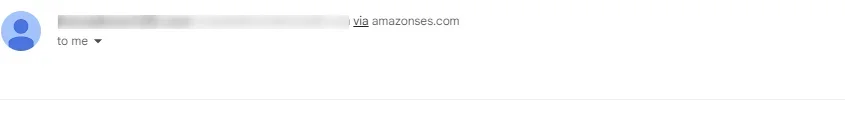

When emailing users in plain text, tracking pixel is still injected if email tracking is enabled resulting in blank looking emails
A temporary workaround would be to not use plain-text email (even if it's only plain-text).
If you go into the DigitalPoint\Analytics\XF\Mail\Mailer.php file and change this:
PHP:
if (!empty(\XF::options()->baEvents['email']))
...to this:
PHP:
if (!empty(\XF::options()->baEvents['email']) && !empty($return['html']))
It should sort it out (it simply won't try to track if it's not HTML, since it can't).
