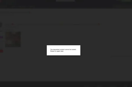

I have used rclone to upload all data,attachments and xfmg and the images are displaying. However when clicking on an image I get the error below.
In addition, if I try and download an image i get the error
<Error>
<Code>NoSuchKey</Code>
<Message>The specified key does not exist.</Message>
</Error>
Further, as we are testing on a dev server, once we are ready to move to production is it possible to change R2 to use our main domain and not the dev.oursite.com subdomain ? If it easy to change rather than upload all the data again to R2 ?

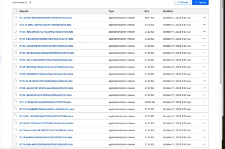

Either the object in question didn’t get uploaded, or (most likely) didn’t get uploaded with the right key. The key is part that looks like a path/filename. If you post a screenshot of what your path/names look like from your R2 bucket from Cloudflare’s dashboard, it should be easy to spot (missing or extra “folder” at beginning is probably the issue).
You can change the public domain of your bucket, yes (I think that’s the question?).
I believe rclone has a sync option, but I don’t personally use it, so probably better to check rclone’s documentation for more definitive answer on that.

I think looking at one of your other posts there needs to be a path /attachments , data ect at the beginning which if you look at the screenshot we dont have. I am a little unsure how to add this as using rclone I used the command below.
rclone sync /var/www/html/REDACTED/community/internal_data/attachments/ r2:/attachments/ --verbose --transfers 20
If anyone else knows how to ensure the correct path is added that would be helpfuil.

I'm not 100% sure (again, I don't use rclone myself), but from the looks of it, I think this is what you are after:
rclone sync /var/www/html/REDACTED/community/internal_data/attachments/ r2:/attachments/attachments/ --verbose --transfers 20
The r2: part is r2:/{bucket name}/{path}/
You just happened to name your bucket "attachments" to add to the confusion there?
So the command you gave had no path... so stuff just went to the root of the bucket.
That makes a lot of sense. Ill give that a go. Thank you again :)

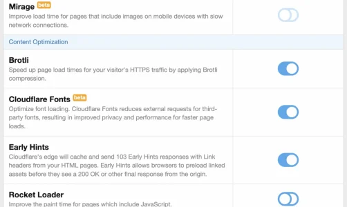

Cloudflare Fonts seems pretty cool if you are using Google Fonts for anything. Some info on it here: https://blog.cloudflare.com/cloudflare-fonts-enhancing-website-privacy-speed/
It's a toggle you can turn on and off (that's all you need to do), where it will convert use of Google Fonts into something served from your own domain, with less HTTP requests rather than Google's domain.
As an example, it's in-use here: https://appforcf.com/
The template for that page contains:
HTML:
<link rel="preconnect" href="https://fonts.googleapis.com">
<link rel="preconnect" href="https://fonts.gstatic.com" crossorigin>
<link href="https://fonts.googleapis.com/css2?family=Outfit:wght@400;700&display=swap" rel="stylesheet">
Normally that causes 4 HTTP requests to various Google domains for CSS and the underlying font files. With Cloudflare Fonts enabled, it's reduced to a single HTTP requests to your own domain (which can be multiplexed with HTTP/2 or HTTP/3) with better cache control. Definitely makes things faster. The single HTTP request ends up being to:
https://appforcf.com/cf-fonts/v/outfit/5.0.11/latin/wght/normal.woff2
You can open up DevTools in your browser and look at the underlying HTTP requests if you want.
TL;DR:
If you use Google Fonts, Cloudflare has a new setting to make using that font faster/more secure.

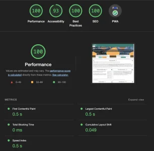

I haven't tested it too much (like if they are prefetched or anything), but it definitely had a measurable improvement on the page I used it on. Even with XenForo 2.2, loading jQuery, using Google Analytics and loading Google Fonts, the only thing Lighthouse is complaining about is accessibility things (it doesn't think the contrast ratio for links/buttons is high enough). Most definitely wasn't that high without using Cloudflare Fonts.
