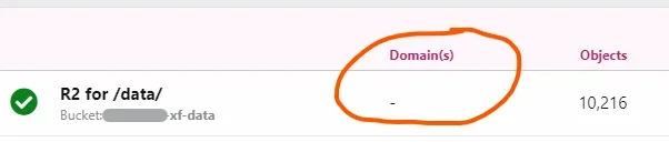

Another snag.
The internal_data subdirectories have been migrated and are working properly.
The data directory, though, wasn't so successful. It broke things, so I immediately disabled it. The data directory contents have been migrated. Maybe I'm not understanding what is supposed to happen with my selections here:

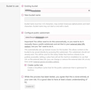

The way I'm understanding it...
1) "This subdomain should not already exist." It didn't. Yet I didn't see it added to my domain records, and there was no "Domain access" set up with the bucket either.
2) " Setting a value here will set this XenForo installation to use that URL as the external data URL (you can change or remove the external data URL at any time under External service providers options." Mine was blank--I took this as meaning it would be filled in automatically.
I also noticed this--the domain did not populate my list of R2 buckets in the XF Cloudflare add-on admin:
Maybe it doesn't like a domain like data.forum.mysite.com? I tried it another way (forumdata.mysite.com) and that did not work either.
So tomorrow I guess I'll try manually 1) creating a new DNS record for forumdata.mysite.com and 2) entering that domain in the "External data URL" on the Service Providers page. Cloudflare shows a public URL for the bucket--I could get the IP address from that. Do I need to make that bucket public first so it will work with XF?
I will have to figure out how to set the data R2 bucket up and XF settings for it manually...
Nothing in the XF error logs. And I already had the R2 bucket created, and chose it from the list of available buckets. (I figured I needed to have all the contents moved over before I turned on the R2 bucket.)

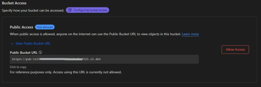

If you go to Settings under that bucket in Cloudflare, the Connect Domain option is where you can give it a public URL manually.
I’ve seen a couple other Cloudflare accounts that aren’t able to do it automatically via the addon for some reason. But haven’t been able to replicate it or able to see it firsthand to try and debug, but you can do it manually.
